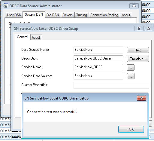

When I use the ISQL interactive SQL I am unable to connect to the database.   I get an error saying "you are not connected to any database" (see attached screen shot).   However if I go into the ODBC Data Source Administrator, go to SYSTEM DSN and configure the ServiceNow ODBC Driver 32-bit, the test connection is successful. (See other attached screen shot).
My guess is I am not entering the command properly in the ISQL command window, but I am not sure.   Would you please look at my screen shots and make suggestions?
