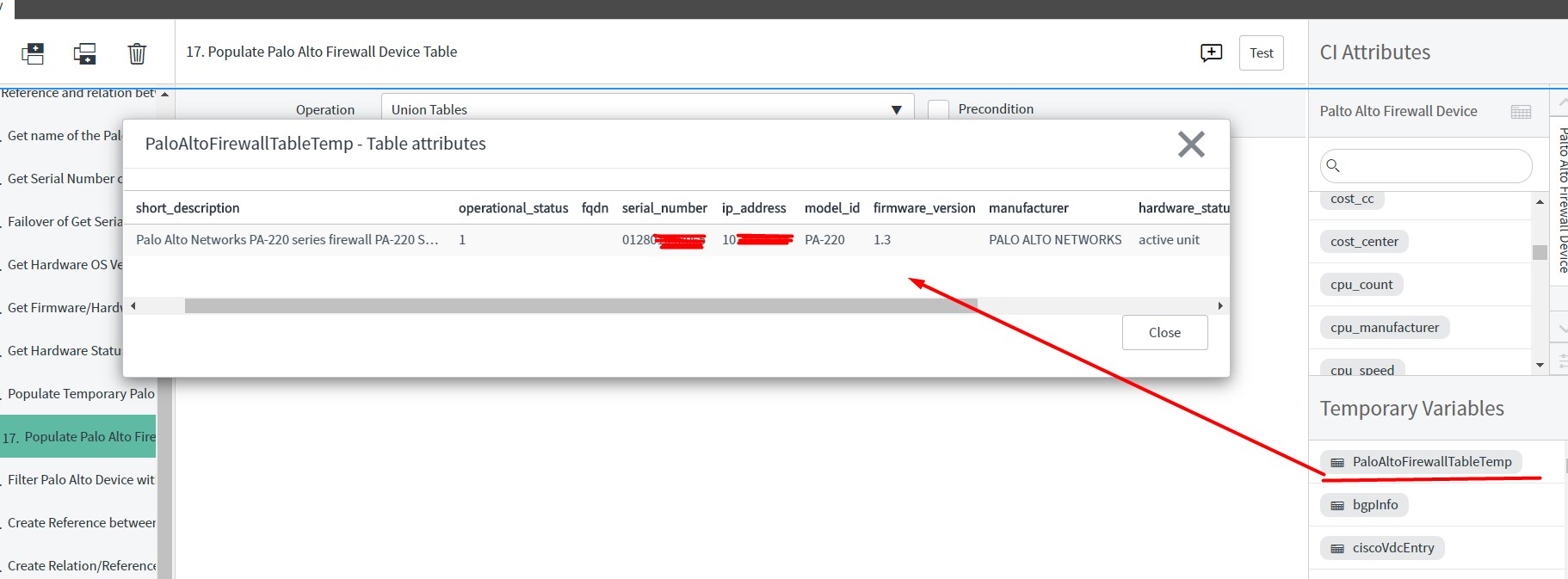

HorizontalDiscoveryProbe Input payload doesn't contains required attributes, but as I can see, pattern collects all data successfully:

Hi Abhishek,
Thank you for reply.
There are no any records on Palo Alto Firewall Device table created.
As I can see on 16th step generates Temporary table and there is result on the 17th step.
All required data were collect and the system must create a new record for specific device, but it happends nothing. If it possible that there are table security restriction or maybe I should populate cmdb_ci_firewall_device_palo_alto table with another operation?
