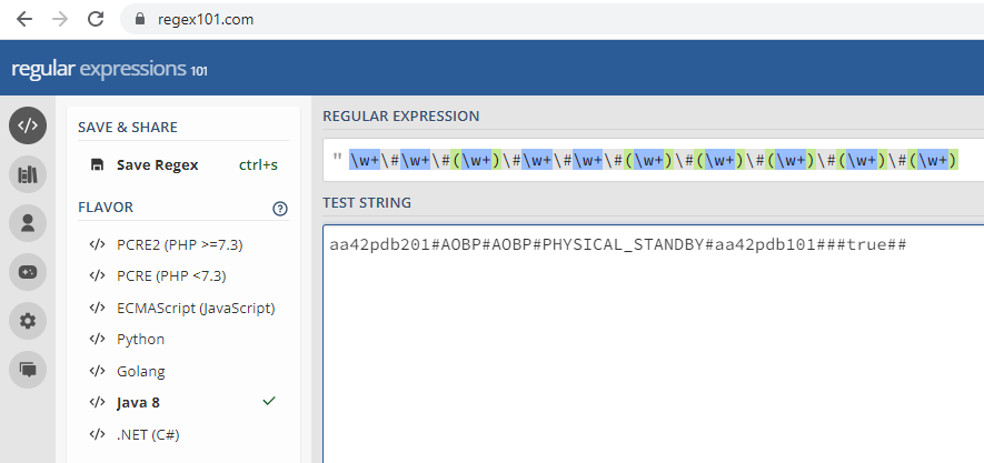

I Define Parsing to use Regular expression instead and I use this filter:
\n\w+?\#\w+?\#(\w+)?\#\w+?\#\w+?\#(.+)?\#(.+)?\#(\w+)?\#(\w+)?\#(\w+)?
I validate in in regex101 webpage and it looks good:
But when I look at the log the data looks empty 😞

Ok.. Maybe this was a tough one to solve since I didn't get any feedback on the post, but I had to solve the issue anyway.
I can now say that the issue is solved, but not the way that I was hoping. Yes, I used RegEx to filter out my issue. It seemed like the RegEx that I used worked on RegEx101-website, but not in ServiceNow. So after some feedback from a collegue I did debugging on the file and tried to build up a RegEx from step by step and make sure that the right events was captured.
But since I never got the linebreak (new line) to trigger/work I was able to modify the output-file and exclude the header. And by adding the RegEx below I got the desired match:
If anyone have good experience with RegEx in Pattern Designer and know of a better solution, please update the case and I can test it and update the answer if so.
But for now I concider this post "solved".
