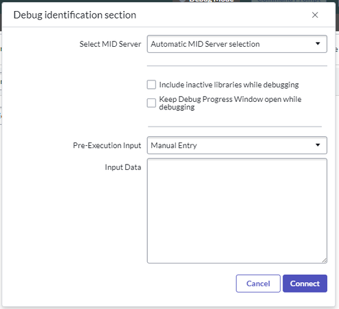

I'm trying to launch debug on pattern "Amazon AWS Service account"
This pattern has input parameters that I need to set.
I see the debug windows has a "manual entry" option, with an "Input Data" text box.
But I can't find any doc that explains the expected format of this "Input Data".
Anybody knows ?
SiD2
Hi @marcguegueniat
This option is not applicable for these types of patterns and is for patterns of type "Cloud Resource" or LP patterns.
You must select the "None" option for this pattern and input values in the above area.
However, the best way of initiating debugging on the pattern is to launch by clicking the "Debug" button from the discovery pattern log. It opens automatically with prefilled inputs, and you can connect and start debugging.

Interesting,
However I can't see any Debug button.
I should see it on a sa_discovery_log.do form ?
SiD2
@marcguegueniat
Yes, the moment you select on the identification section name then only you will see the Debug button on right.
