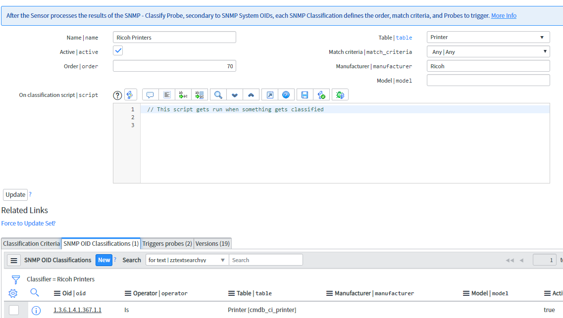

I am Discovering Ricoh printers across our footprint using a Custom SNMP OID Classification:
The challenge I am having is to distinguish between Model IDs.  The only way I nave been able to have these devices discovered as printers us by using the system OID, otherwise these come back as IP Routers.
Looking in SNMP-Classify I can see I am getting the data I need
And
What I am failing to get is how I can specify both that these devices be classified as printers and that the Model ID matches what I am getting via SNMP.
Thanks in advance for your time and help...

Thanks for your reply.  Yes, I am using the ObjectID as you describe but my issue is that the printers are certainly different models all under that very OID.  What I am hoping to achieve is find a way to further differentiate these devices so I can populate the Model ID correctly.  I am thinking that since there is additional, relevant information coming back from the devices, what I am lacking is the mechanism to use it correctly

Do you have any recommendation about what can I use to build the criteria?  I tried "sysDescr" is , but I am not getting any result. could I use an OID there?
