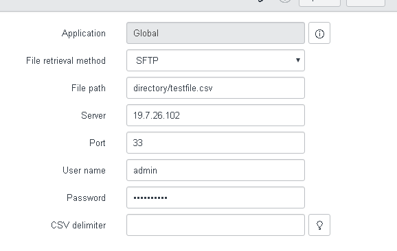

we are using Scheduled Import for importing file from mid server and pushing to target tables(we have Data Source)
we don't have any discovery inplace here....
more info check this link : Scheduled import error

"TCP: Connection refused" - Sounds like a firewall issue on the server you're trying to connect to.
"scheduled import job" - Is this a probe over the mid server, or are you importing records into the instance with sftp / scp, or what?
‎09-08-2016 02:02 AM
we are importing records to our instance for Mid server through SFTP
Can you please check this URL : Scheduled import error
