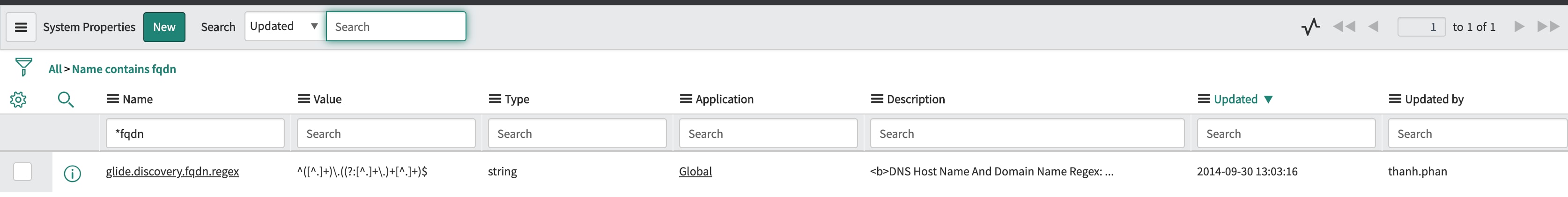

4. We also have another system property which defines the fqdn based on regex.
Code is defined in HostnameJS script include.

4. I see this._parseFQDN(sysName); in HostNameJS script's format method. The parser would have failed based on the regular expression used.
