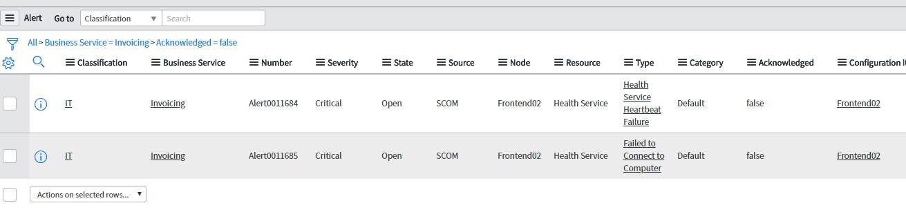

Hello!
I'm trying to run a report which will show a count of alerts for technical services, but having trouble finding the table structure connection between the technical services (cmdb_ci_query_based_service), cmdb_ci, and em_alert tables. I would assume this connection exists, due to the Event Management dashboard's list of alerts building a list off of technical services (/nav_to.do?uri=%2F$sw_dashboards.do). I just want to be able to run reports using the reports system. Does anyone know the proper path (for dot walking or whatnot) to run this type of report?
Thanks!

Hi
You can use the table called Alert [em_alert_bs_status_view] and then create a condition for your service. I have created one for a Manual Service (you would just select technical instead), which shows i have two alerts on my service (Invoicing).

Hi ,
Michael is right. You can you the table em_alert_bs_status_view to generate the report. This table has a field Business Service which contains all the business services such as manual or technical.
So while building a condition build it as- Business Service is "your technical business service name".
e.g   Business service ---is----technical service. By this you will be able to see the alerts associated with this technical services as well as count
