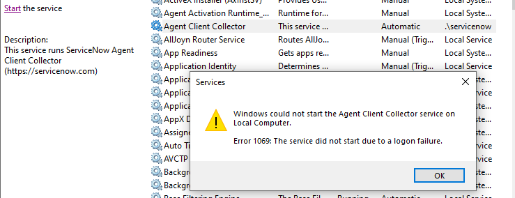

ACC V agent unable to communicate with my Instance, so stopped the service and when I want to start the service, I'm getting error like below;
I tried to start manually as referred the docs says, but not option disable to restart.

I would check the status of the local servicenow account on that server (.\servicenow), I suspect you might find that is the cause of your issue.
Check it is not disabled and has log on as a service rights, you might potentially have a password issue too.
Hope this helps,
Richard
‎02-06-2022 12:30 PM
When you install the agent, it also installs the local user/pass which is used to start the agent. Most likely that user has the policy to change the password after x days. This means Changing the password at the next logon gets activated. So after that when the agent/server gets restarted it will throw this error. Try to untick that open and restart the agent hopefully it will start...
