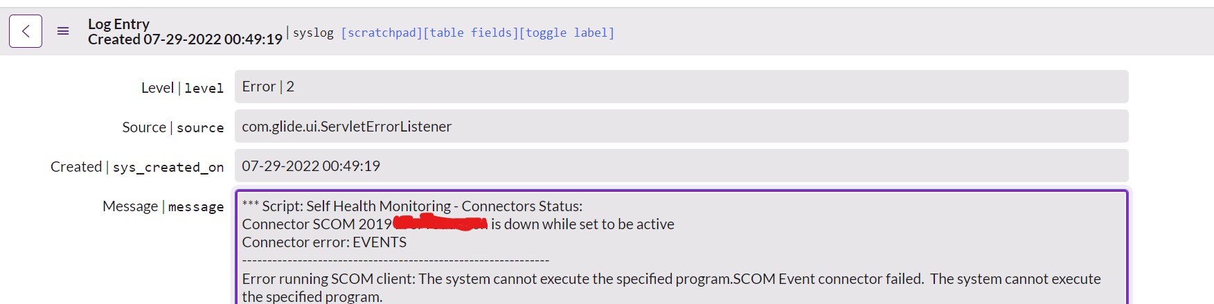

We are facing an issue with SCOM 2019 connector, after test we're getting below error:
EVENTS
Error running SCOM client: The system cannot execute the specified program.SCOM Event connector failed.  The system cannot execute the specified program.
This connector was working as expected however this failure has stopped its functionality.
Do you know what could be the cause of this failure? what else we may check to fix this issue?

The additional logs you provided suggest that the binary the MID server is expecting to invoke will not run. The reason it will not run looks to be in the log entry screenshot.
"Cannot be closed in SCOM as the monitor which generated the alert is still unhealthy"
It looks like SCOM itself is rejecting the alert closure.
