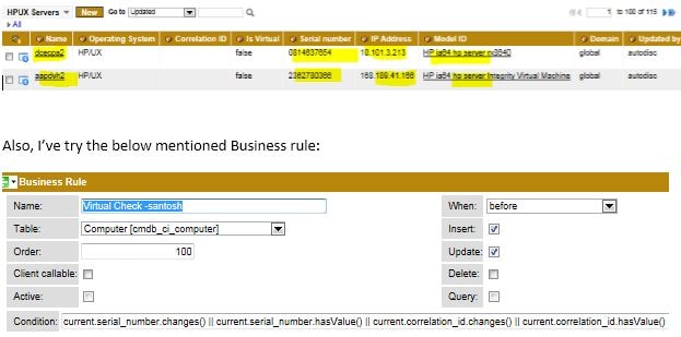

Can you post a screenshot of a few example records? That particular business rule checks for VMware, solaris zones, and a few other types of VMs IIRC by serial number. What do the serial numbers and model ID for those say?
Please have a look the below screen shot:
Also, I've amended the Business Rule (highlighted in yellow color):
