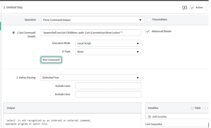

We are customizing the certificate discovery for our client. "Get-ChildItem -path  Cert:\CurrentUser\Root | select *" is the command we're making use of in the pattern to get the certificate details. We are using powershell.exe in cmd to execute this. But we are having trouble including this whole line. We are only able to include till Root and get the output.
If we include " | select *" we are getting the error "'select is not recognized as an internal or external command,
operable program or batch file." How do I execute this command in the pattern step?

Answering my own question, the solution is to escape the pipe operator by using ^|
The command is failing because the pipe | is being interpreted by the cmd shell and not by PowerShell as explained here
