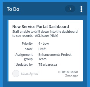

I am trying to Create a Due Date field on my cards displayed in Visual Task Board (the Kanban wall, not table). I have it in my table as a column, but I want it to display on my Cards in my visual task board wall. is this even possible?

There's a vtb view which decide the fields to be displayed on visual task boards. so open the form in vtb view and configure the form layout to bring that field on form.
https://instance_name.service-now.com/table_name.do?sys_id=-1&sysparm_view=vtb

Did that but the due date field is still not displayed on the Visual Task Board card.
Any other solution/idea???
Got VTB View setup in Form
However, that did not change the view in the VTB itself - Due Date field is still not displayed and it still showing Assignment Group instead of Assigned to Field.   Am I missing a step???

If you go to the UI View table [sys_ui_view], open the record with name vtb. Locate the table concerned (for example if your VTB displays Incidents > incident) listed in the Related List Form sections. If you open the form section, have a look at Related List Section Elements. Here you can add/remove fields, in your case add due_date.
