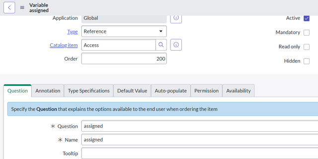

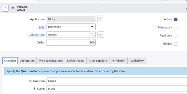

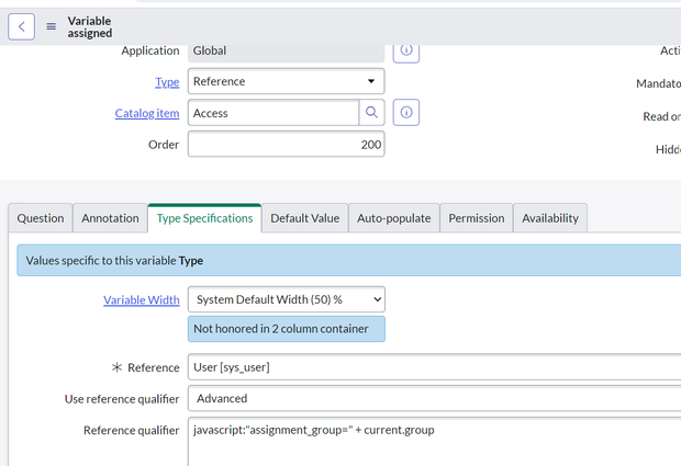

Created Advanced Reference Qualifier in Catalog Item (with variables 'group' and 'assigned')
to fetch values of users only of selected group.
But this is not working

@shivani18 Please modify the reference qualifier as follows.
replace assignment_group with group in your reference qualifier.

@shivani18 Your Advanced reference qualifier seems correct. However, the table you have selected seems incorrect. Instead of choosing User[sys_user] table you should choose Group Member[sys_user_grmember] table as the assignment group field exists on Group Member table and not on User table.
Please mark the answer helpful and correct if it manages to address your issue.

I modified the table name as you suggested.
But still many records it is fetching (other than members of the group) and it is now fetching sys_id,
instead of name of user.

Hello @Sandeep Rajput ,
I updated reference qualifier and sys_user_grmember table as you suggested above
But still it is providing same results
