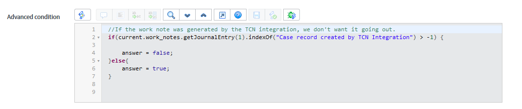

We have a Notification that will send if conditions are:
  1. Active is True
  2. Assigned_to is not empty
  3. Work Notes changes
We have been asked to modify these conditions and suppress the Notification from sending if the recently added work notes contain a specif phrase that is entered by a integration.
I'm testing the possibility as seen in the image below, but I cannot prevent the notification from sending.  I suspect the Advanced Condition is not entered correctly.  Any suggestions?
I believe I have something for you. Try:
var worknote = current.work_notes.getJournalEntry(1);
if (worknote.toLowerCase.indexOf("Case record TCN Integration") > -1) {
answer = false;
We needed to grab the last work note first, then check for the phrase.
Try that!
answer = false;
Try that!
kevinthury
Thanks Allen!  I had to make a slight change to your script, but you provided the base and got us on the right track to success.    Here is the final script:
Nicely done! Glad you got it working!
