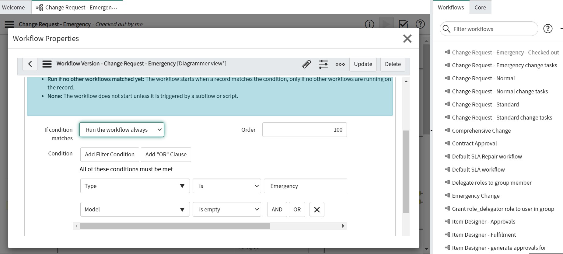

pawan k singh
Follow below steps.
1. Navigate to New Workflow--> Checkout the workflow --> Go to "Properties" and under "Conditions" tab copy the Trigger conditions as old workflow. For Ex: To change Emergency Workflow, you can update the new workflow properties as below.
2. Now go to old workflow and make them as Inactive by following as below screenshot.
Please mark this helpful/ if it helped you.
