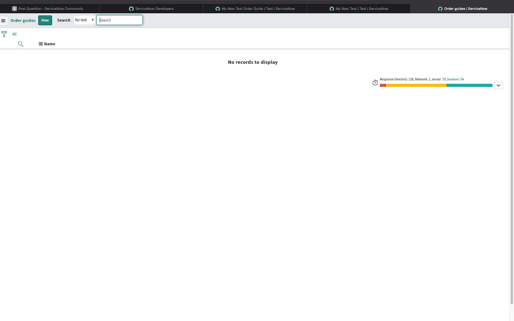

ATF: Unable to open Order Guide in ATF as its empty
Sarah Qureshi
ATF ::
  1. New Test
  2. Service Catalog in Service Portal
  3. Open a Order Guid (SP)
  4. Click Arrow glass for Order Guid
  5. List will be empty
  6. Any idea how to populate?
  7. I can navigate to Order Guide and see two items there. find_real_file.png

Sarah Qureshi
I was able to solve this by copying the Order Guide and the new order guide will show up in the list.
DylanB
I also came across this issue. In my case, I intentionally did not have a Catalog selected for the Order Guide as a way to prevent users from searching for it in the catalog.
I added the Order Guide to the Service Catalog catalog (which is the only one we have) but the Order Guide still did not show when I had the portal of Employee Center selected in the ATF Open an Order Guide step. I changed my portal to Service Portal and then my Order Guide appeared.
It seems that Order Guide field applies some querying parameters to it's search, which I'll assume is what's causing the issue.
