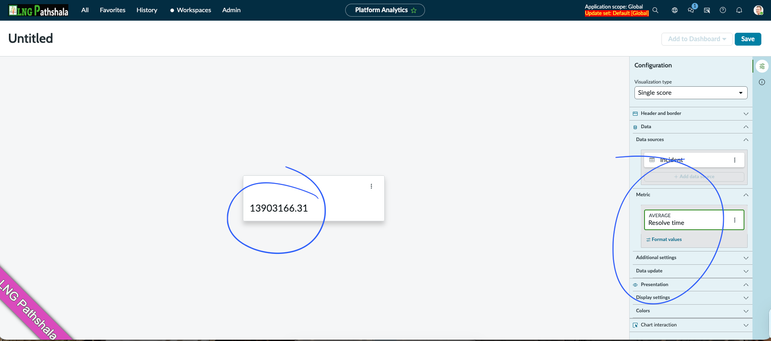

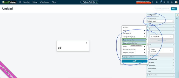

Dr Atul G- LNG
Hi @mania
create a single score report

Dr Atul G- LNG
Hi @mania
Thankyou and it worked.
Previously tried on case table so i am not able to fetch that field and after applied in incident table same as per you screenshort it worked and again tried on case with dot walking so it worked in case as well.
