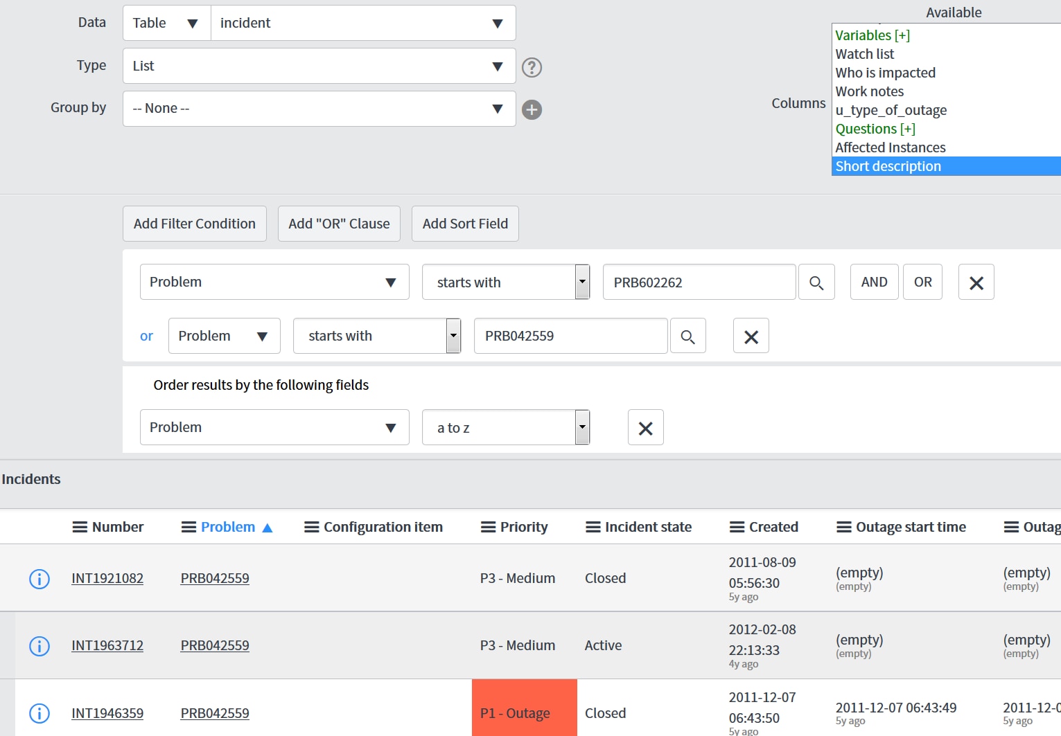

johnbarber_now_
Blaze was on the right path, the best way to get a report of all the incidents under a specific PRB is to go off the Incident Table in reporting and filter for the PRB you are wanting to report upon. If you don't choose to "group by problem", you will get a simple list of INTs, you can add some cleanliness to your list by adding a sort field and sort on PRB Number. Then schedule the report delivery and you should be good to go.
List of INT
Note: If your list of PRB to report is long your query can get inefficient pretty quickly and in general reporting on static set of PRB# is challenging to manually maintain, so I would recommend putting a Tag on the PRBs you want in your report or a checkbox field in the PRB form, basically anything to designate the PRB as needing to be in your report, then you can filter on that designation that value, instead of a static PRB number, by:
1. Opening the "Show Related Fields" option at the bottom of your filter list: (Note: you may need to expose this option using Instance properties)
2. Find "Problem ===> Problem Fields
3. This will change the Filtered list of fields to all the PRB fields and you can then select the distinguishing field/tag you have set up and get all the PRB you want to report upon, and bring them into your list. This way you can dymaically control what data flows into the report, by simply marking the PRB that need to be on the report before it gets sent out.
I hope this helps to answer your question and you to build the reports, if it does please mark it as such.
Thank you
John B
