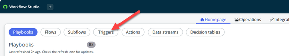

The best method for this would be to create a new Trigger in Flow Designer:
From there you'll be able to select the type of trigger you want, being a scheduled trigger you'll choose "Recurrence":
Continue Building your trigger, from here you'll choose business calendar and select the business calendar that you want to tailor it after. You'll need to create the business calendar with the availability you want, but I assume you've already setup business calendar already.
