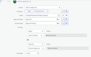

So, to accomplish this in a flow, when the flow for the Authorize stage gets triggered, I am doing the following Process Parts in parallel:
1. Apply change approval policy to get CAB Approvals and approval from the CI manager.
-> After this, the flow will check to see if there are any new manual approver records added,  IF there aren't then it will evaluate change model and move the change to scheduled.
-> IF there are then it would "Ask for approval", then it would do another check to see if there are still pending approvals from the manual approver added in the assess stage.
2. Check if the change gets reverted to new (as per baseline flow design)
**Nothing to worry about with this part of the flow
3. Use the 'Ask for Approval' action (approve if all manual users approve) to ask approval from the manual approver added in the assess stage.

We had similar requirements where we needed to add an additional approver group at the Authorize step. We initially tried to achieve this by using flow approvals in parallel. Later, we discovered that flow doesn't support parallel approvals. However, there is a workaround if we are using multiple "Ask for approval" action parallelly. But if we use "Apply change approval policy" and "Ask for approval" actions simultaneously in parallel, it won't function as expected due to Flow Designer limitations. In our case, as soon as the additional approval is approved or rejected, any concurrent "Requested" approvals are moved to "No longer required." The only solution we found was to use approvals in sequential order.
ServiceNow, also has a community video on their YouTube channel discussing about this issue and workaround.
