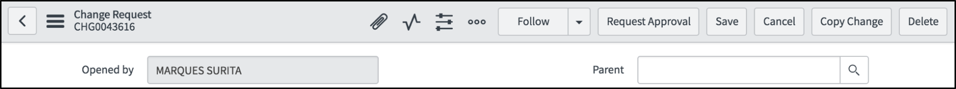

On an incident record, I right click the banner to open a CR to resolve the incident. This creates a relationship between the two- On the CR, the related list Incidents Pending Change displays the INC which I created the CR from
Notice that the Parent field is not populated with the INC#, although it was created from an INC
