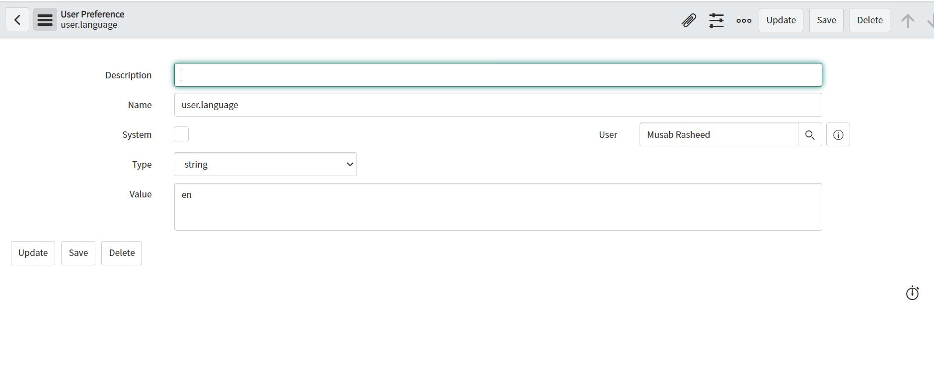

Lastly if portal option doesn't work then go to 'sys_user_preference' table and create entry like below.
