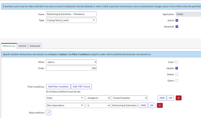

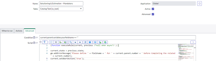

Thanks, @Jerick I, for your notes.   The final solution is a variation of your suggestion. Rather than using "current.parent.variables.my_variable" I took out the "parent" part and used "current.variables.my_variable" to read the variables on the form before they are saved to the database.

@Joe Trimble As far as I can recall, you cannot dot walk the variable on the ui policy condition; you can try to create a business rules, which check the field value before triggering and deciding whether to accept or abort an action if the task is closed. See also the basic business rule below on how to execute this on sc task.
