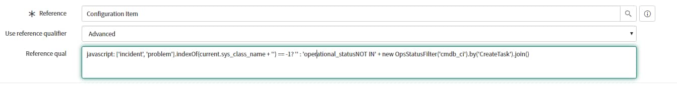

I recommend starting with the reference configuration of the CI field.
If you right click>configure>dictionary on your CI field, what does your reference qualifier have in it? My guess is that the ref qualifier is linked to other selections on the form, and is returning no results because nothing matches in the query. It could be a simple condition, or it could be advanced and referring to a script include that is doing the lookup for you.
Check it out and let us know what you find.

Hi Stephen,
Thanks for your reply! This is what it is showing right now:
I am not great at reading script so I am not sure if that is what it is supposed to do or not. I don't know how this would have gotten changed if this is the issue. Let me know if you need any additional information. Thank you!

Has this reference qualifier or the script include OpsStatusFilter changed recently? Can you look at the versions of these two to begin with?
12-05-2019 07:26 AM
Not to my knowledge. I am not very familiar with what you are asking, sorry about that. Our developer handled setting this up and it had been working fine until now and the only changes made were the ones I mentioned before.
