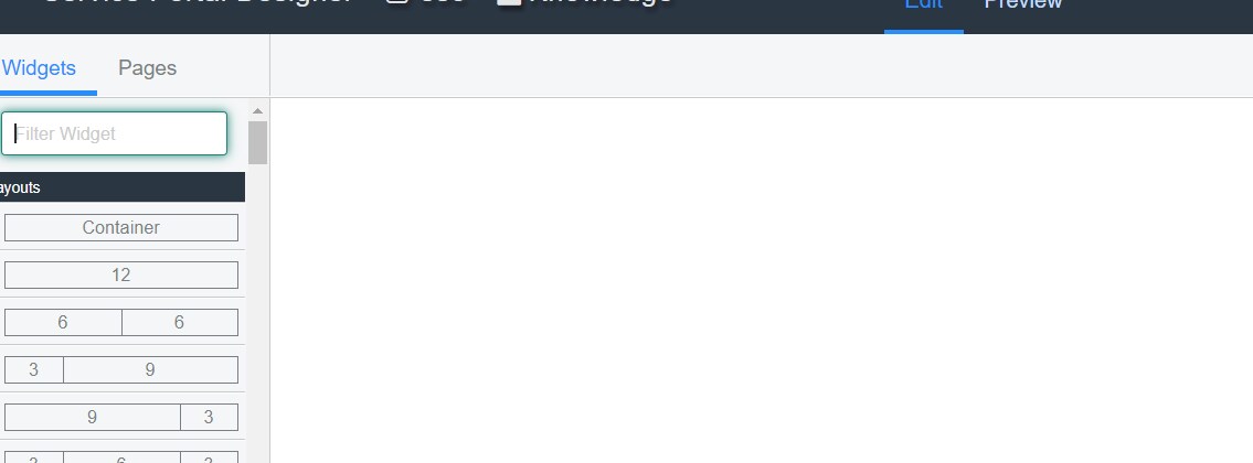

By cloning the widget will give you the duplicate widget but u need to drag the widget in the place where you want it
open the portal page where you want to make changes ,right click on the page and click page in designer
which will open a new page and in the left search bar search for ur new widget and drag it where ever u want it .. this will fix the issue
