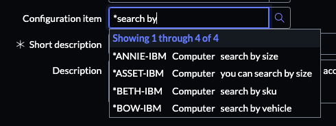

In the typeahead search like you have pictured you can add columns and search on them - to some extent. This is an easy configuration change, not a customization. The problem with what you've laid out is that the Description field - being a multi-line text - is too long, and tags are records on a different table, so that's a whole other issue. But this is what it would look like if you were to populate certain words or phrases in a string field - one that's unused on the cmdb_ci table, or create a new custom field. As seen in Dark mode, which makes everything look better:
This also includes the sys_class_name (Computer) which you could get rid of. If I were to continue typing ' size' the results would be limited to just the first 2 records.

For this demonstration I used the category field. Make sure whichever field you use is on the cmdb_ci table, not an extended one. I modified the incident record in the Dictionary Override Related List on the Dictionary Entry, so that this change would only apply to the incident form, not problem, change, *task, and everywhere else Configuration item is seen. I copied the Attributes that were on the out of box Dictionary entry for the task table adding
;category
and
,ref_ac_columns_search=true
encode_utf8=false,ref_ac_columns=sys_class_name;category,ref_ac_order_by=sys_class_name,ref_auto_completer=AJAXTableCompleter,ref_contributions=task_show_ci_map;show_related_records,ref_ac_columns_search=true

I have it working now, thank you! You did it the exact same way I had tried, but I used the "Description" field. I think when I first tried it with the "Description" field, I used the field name description which is what most tables use for that label. But on the base CI table the field name is short_description even though the field label is Description. When I changed to short_description everything worked.
