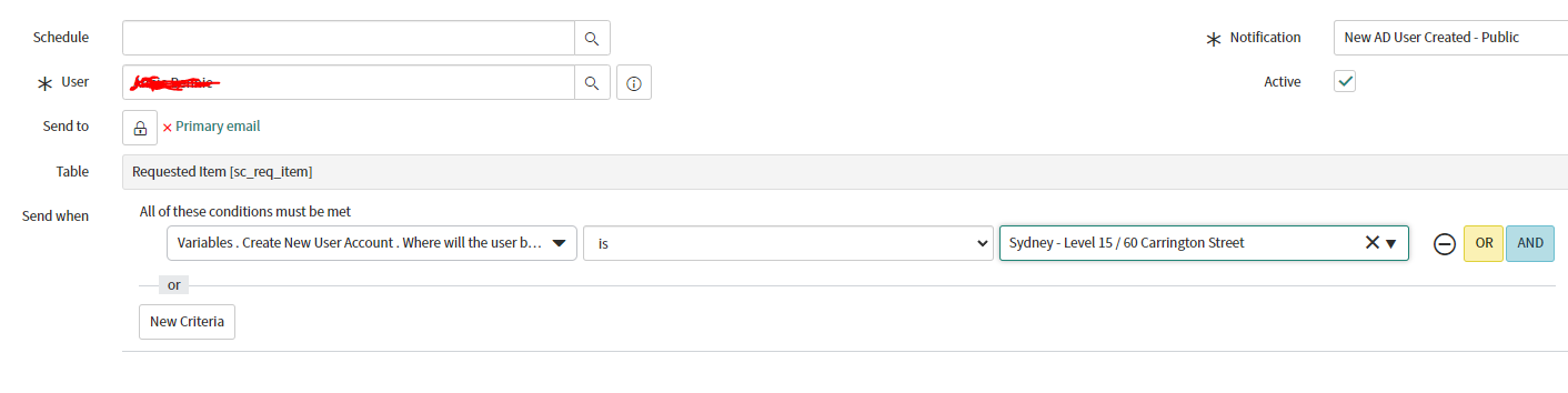

this is working as expected, however the email is being sent on every new user creation - which i anticipated. I wish to filter it to only go to this person when the new user is in the location requested. I set a filter for "send only when" to variables -> (cat item) -> (variable) is (correct office) as below
however this results in no mail being sent. I assume it's something to do with that it's looking at the sc_req_item table, but the notification is being fired by an event (although the notification is tied to this same table - see below).
is anyone able to suggest to me what i should be doing to achieve this?

Just an update, I couldn't get this working using subscription notification filters, no matter how i tried.
What i did was create a fairly generic email template that can be re-used, and then create a specific notification for the office in question that filters by one of the event parameters which contains the office.
This way if other people want the same thing (which they will when they find out about it), I can add a new notification that re-uses the email template and no workflow changes are required.
