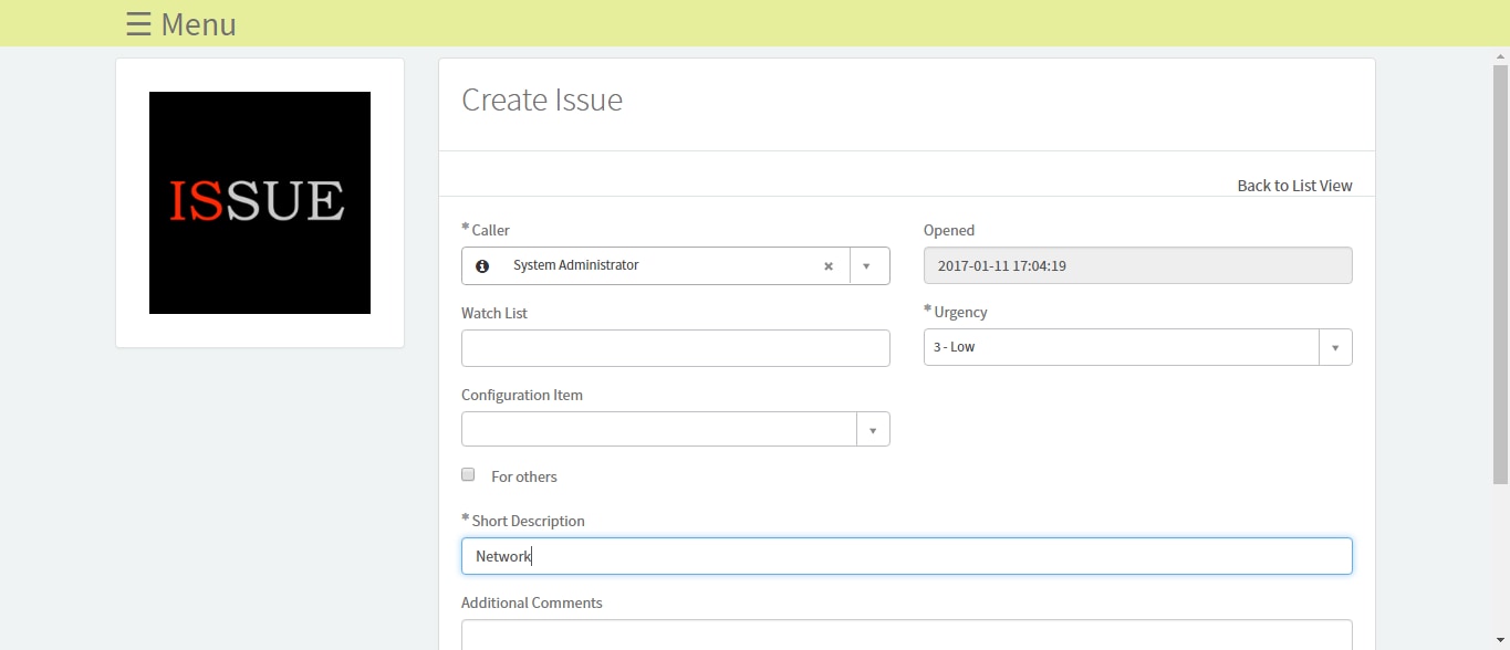

First of all yes I am telling about Service Portal. Actually I am showing the record producer in the portal page. Like,
This is my record producer. This is a replica of incident form which is mapped with the incident table. The is the service portal view. The previous picture I have shared that was also the record producer but from inside the instance.
So in the instance view we can see the contextual search results according to the content of the short Description. But in the portal view I am unable to see the contextual search results.
Please Help me out.
