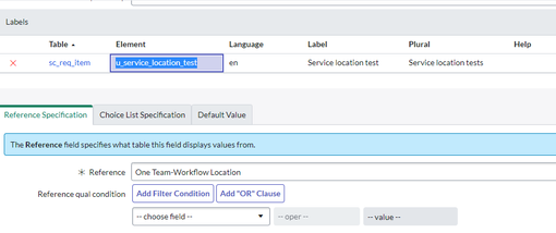

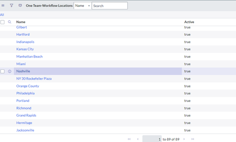

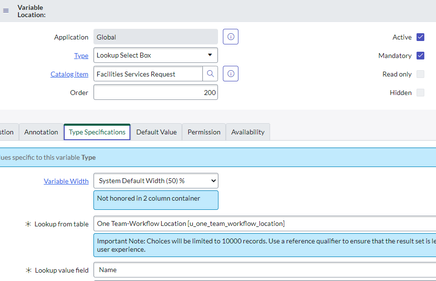

I need to copy catalog item variable field value [location] which is a reference field referring to custom table [u_one_team_workflow_location], to custom field [u_service_location_test] on RITM which is also reference field referring to same custom table.
I have tried all possible ways but unable to get the value on RITM field [u_service_location_test].
please refer the image
custom table:
custom field on RITM
Variable on cat item

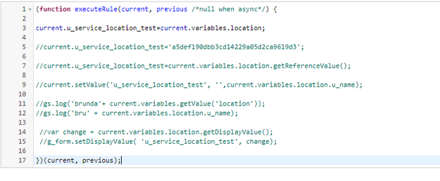

Tried Solution
before BR on sc_req_item table on insert and update

‎11-30-2022 09:35 AM
Please check what value is coming in current.variables.location. Please use the below code and let me know what value is coming in location.
gs.log('location'+current.variables.location);
var ritm_gr = new GlideRecord('u_one_team_workflow_location');
ritm_gr.addQuery('name', current.variables.location);
ritm_gr.query();
if(ritm_gr.next())
current.u_service_location_test=ritm_gr.sys_id;
current.update();
})(current, previous);
‎11-30-2022 09:53 AM - edited ‎11-30-2022 09:57 AM
on logs i am able to see the location i selected when i submitting the request but on RITM its still the same 'Gilbert'.
‎11-30-2022 10:00 AM
I see maybe the name field is u_name in the backend. Then please use the below:-
ritm_gr.addQuery('u_name', current.variables.location);
ritm_gr.query();
if(ritm_gr.next())
current.update();
Please mark my answer as correct based on Impact.
‎11-30-2022 10:11 AM
Thanks a lot !!! it worked.
it worked when I tried above code using Before BR insert/update but when i did same using After BR Insert/update the RITM record itself not created.
