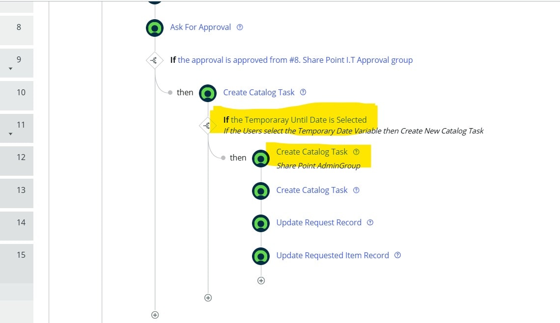

I have to create a Catalog task for the Catalog item if the variable "Temporary" is selected, I have created Flow designer for the Catalog item and the Catalog task should create before or less than 14 days (<=14 days) on basis of Temporary date variable selection please suggest what to write script in the Flow Designer. Please check the screenshot attached.

@G Ponsekar  please follow below steps, i have tested it in my PDI its working
Flow :
Create a custom action: "Calculate the date difference"
Action script:
var tempDate = inputs.temporary_date;
if (tempDate) {
    var temporaryDateTime = new GlideDateTime(tempDate);
    var currentDateTime = new GlideDateTime();
    // Calculate difference in days
    var diff = GlideDateTime.subtract(temporaryDateTime, currentDateTime);
    var daysDiff = Math.abs(diff.getNumericValue() / (1000 * 60 * 60 * 24));
    outputs.days_difference = daysDiff;
    outputs.within_14_days = daysDiff <= 14;
} else {
    outputs.within_14_days = false;
})(inputs, outputs);
Make sure you create input variables as - temporary_date and output variables as - days_difference and within_14_days
