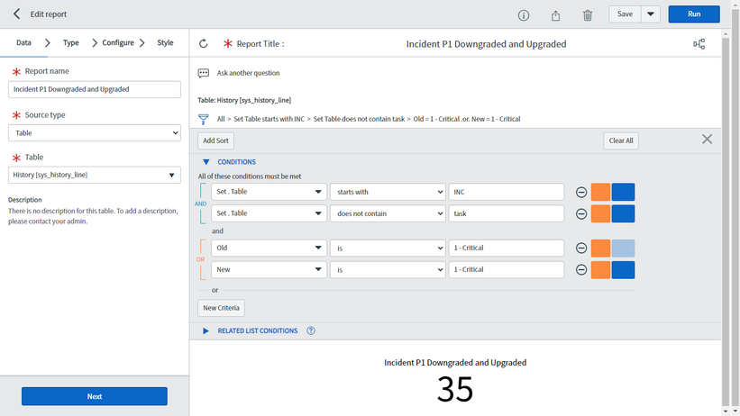

Eddie5
Hi all,
Please create report as per below screenshot, mark this answer useful if this helps.
@Eddie5 , reporting on core system tables may result in platform performance issues and this is not a best practice solution. The appropriate approach is to record the data as a metric, or via additional table field and report against this.
