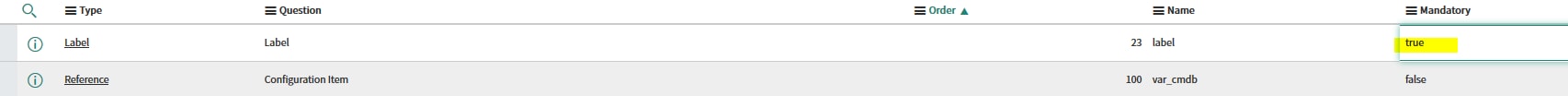

Can you check if there a label type with mandatory is set as true
If yes, you can either set it to false or pass the label type variable in request body with some dummy value
Thanks for the response. The issue was with the variable name. I misspelled one variable name which caused this issue.
Thanks you and I used the same.
