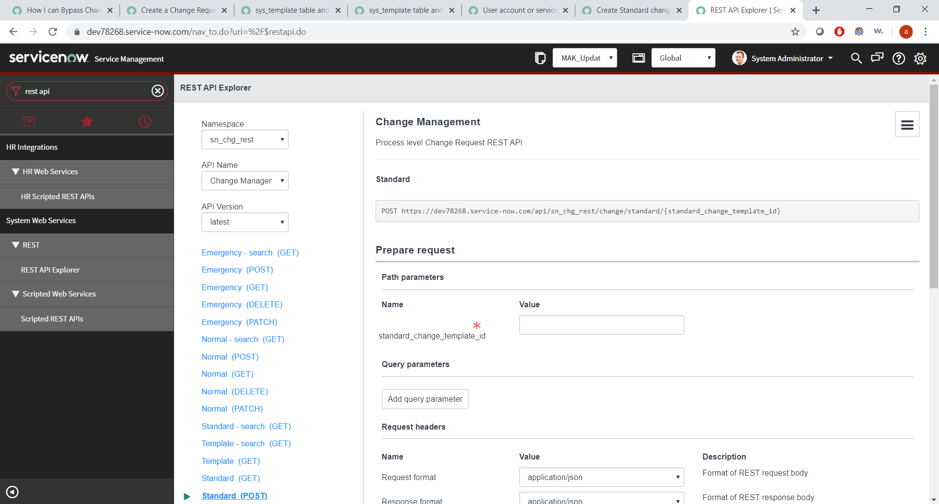

Yes you can. Anthony proposes a good starting point.
It looks like you found my favorite recommendation for third party integrations to ServiceNow - the REST API Explorer.

Can't we just use snc_change_rest - API available in Madrid and pass the standard change template sys_id there using the REST API? instead of Service Catalog API
