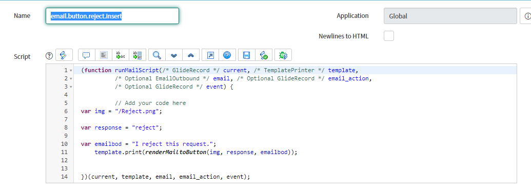

Approve mail script-
Reject mail script-
Script include-
Inbound email action-
Notifications-
Event-
‎11-26-2021 01:51 AM
the inbound action is on approval table and it would update approval record and not RITM
once approval is done the workflow would proceed
‎11-26-2021 01:54 AM
So why is it not working ? Any changes needed in my configurations ?
‎11-26-2021 02:08 AM
what is not working?
Is approval record not getting approved using OOB inbound email action?
Is the workflow not proceeding?
