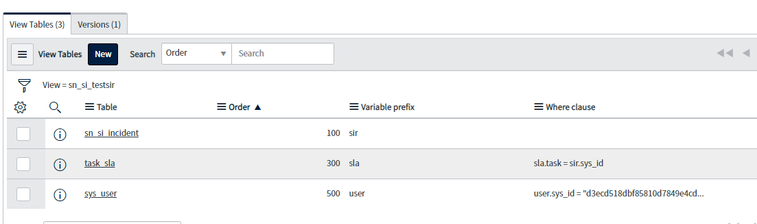

Hi all,
I have created the below database view and need some help with the where clauses.  The requirement is to view all security incidents Opened by "x" .  It should contain information on the user that is assigned to this incident.  and also should include Task SLA details for the security incident.  No records are showing.
If I use the where clause for Task SLA as "tsla_sla"  and I can see records but it's showing millions of records where only less then 1000 security incidents were opened by "x" user.  Any advice will be appreciated. Thank you!
Thanks for your help. I used your suggestion and modified a bit and it's working.  See below.  Really appreciate your help.

@Wendy20 ,
Can you try the below combination, it is giving me correct response as I have checked in my PDI, just change the sys_id according to your user

Hi, Thank you for your response. Unfortunately it did not work. I need to show the security incidents "opened_by" the "X user sys id" and it also has to show "task_sla" details of those security incidents and from the user table we need to see the details of the "assigned_to" user that is working on the security incidents we are seeing.    when I tried your suggestion I could not see any records.
@Wendy20 ,
Could you please share snippet of you DB view, because it worked for me in my PDI
same conditions and same where clause, might be you missed something
