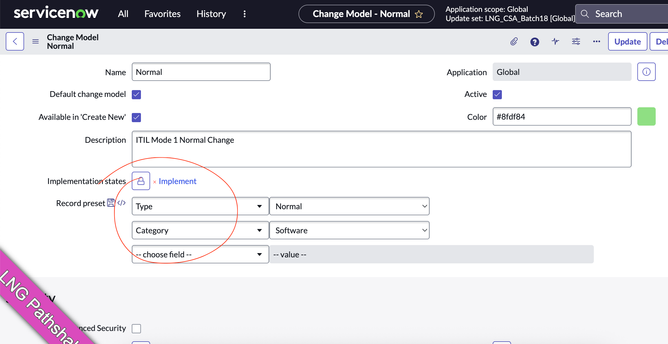

Did you try setting it as the default at the model level itself, like shown below?
I did. That worked except for the fact that those values are now read-only. I need the ability to change them.
