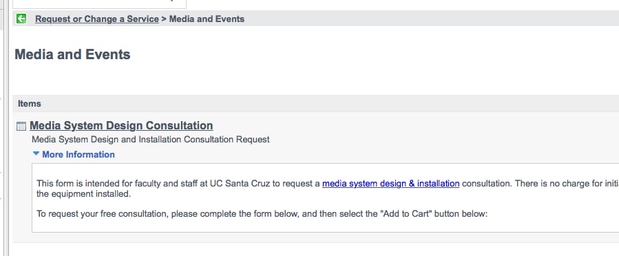

In our service catalog, most of our categories are NOT clickable hyperlinks. However a few recently added categories ARE clickable hyperlinks. We recently upgraded to Euerka, not sure if this is relevant. (see 1st screenshot)
For those few categories that are clickable links, I can click on the category, and then a page loads with details for the service request items within that category (see 2nd screen shot below).
1. The issue is that some categories are clickable, and other categories are not clickable. I want them all to be NOT clickable.
2. I have a second issue in particular, where an entitlement script is restricting access to a service request item, and when the category for that item is clicked, the error page "the entity name must immediately follow the '&' in the entity reference" is loaded, see 3rd screen shot. This error page loads for those with or without permissions to the form. This causes confusion.
The ideal solution: I would like to make it so none of the categories are clickable. Is this possible?
Or if that can't be changed, then can I change the error message to indicate that the user is experiencing a permissions issue?

Removed the ampersand "&" from the category and it worked as expected, without the error page. Thank you all for your input!

The only way I can think of to make those links not clickable is to hack them using a UI Script which is definitely not a very elegant solution.
As for the error message you are getting, I doubt that it is related to the entitlement script. This type of error usually happens when there is an unescaped ampersand in the Jelly code of a UI Page or UI Macro. Are you aware of any customizations to Service Catalog UI pages or macros in your ServiceNow instance? The structure of the catalog category pages is defined in "com.glideapp.servicecatalog_category_view" UI Page and the macros embedded in it. Can it be the case that any of these records are customized?
