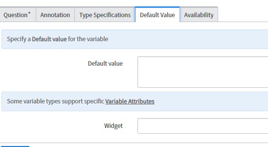

This won't work on the service portal (at least for Kingston and London). To get any form of html/link and all that to show you have to create a widget Service Portal > Service Portal Configuration (in back-end navigation), add your html to the html section of that widget (i.e. <a href="http://www.google.com">Click here for Google</a>), then create a macro variable on the form (catalog item or otherwise) and on the "Default Value" tab of that variable, pick the widget for the widget field:
This won't show right next to the checkbox (like as it's own label), but does allow for HTML/LINK to be placed near it if this and the checkbox are next to each other via sequence order.
