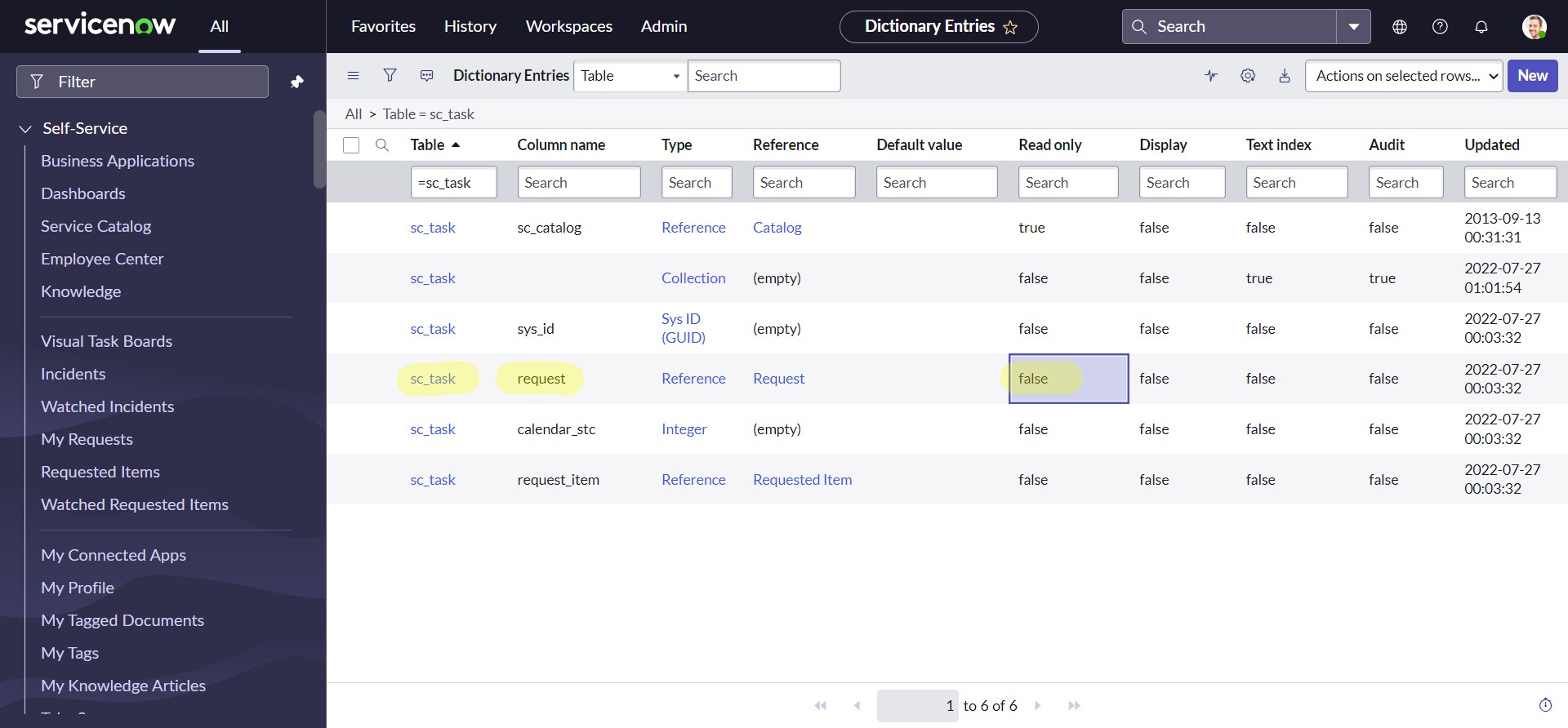

I added a field (from Request) to the Catalog Task form using 'Form Layout' :
At the Request level, the field is editable but in the Catalog Task it's always ReadOnly, i checked Dictionary, UI Policies, Clients Scripts, ACLs but found nothing.
- Request :
- Catalog Task:
I tried adding a new UI Policy and Client Script to make it non ReadOnly, but it didn't work. Does anyone have an idea about this issue ?
Thank you for your help

HI Nessrine,
You have to follow this method
Open the form you added dot walk fields to
Configure dictionary and look for dictionary record referencing to parent table you dot walked your fields from
Check the read-only check box for this record to make all dot walked fields read-only
Mark Correct or Helpful if it helps.

Thank you very much Yousaf for your help, that works for me.
