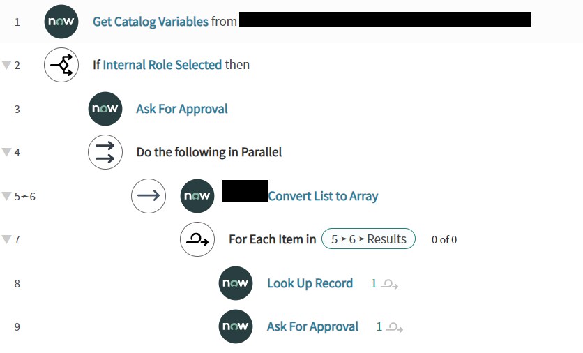

Hello!
I am trying to get approval from the Product Owner of each software selected in a list collector. The list collector is link to the Software Model and the For Each action allows me to use the List but when I try to do a Look Up Record to try and get the Product owner, the data pill from the For Each action is greyed out.
Where have I gone wrong? I need to do this for 6 different list collector fields in the same manner but on different tables.
Any help would be greatly appreciated!

refer my blog for converting the string into array of string
if that helps please mark it helpful and also bookmark it
Using list collector in Flow Designer 'For Each loop' by converting string into array of string
