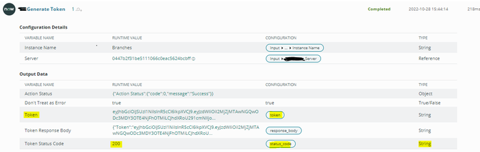

I have designed a flow and when I try to run it, it fails at if statement.
So, I have used an action to fetch "Token" and "Token Status Code", i.e. if successfully fetched it returns 200(string) as status code,
Now until this part it executes fine, after this it has to evaluate in "if" statement if "token status code" is 200 .
This is evaluated as false by if statement. even though 200 = 200 as evaluated by it in screen shot.
Any help is appreciated.
