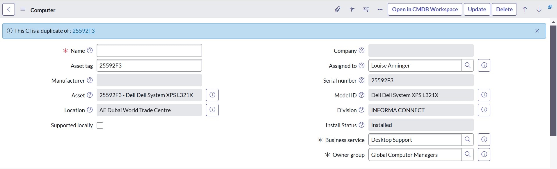

AbdurRahmanSnow
I found the solution for this using ACL. I combined the answers from @Viraj Hudlikar and @Mark Manders.
What I did was., (below). (Also, UI Policy script was not working properly. Therefore, removed.)
1) Firstly, I created a table.None (Read operation, irrespective of the Role).
2) Then I created table.Fields for all the fields, one-by-one, inside those field ACLs, then I gave "Write" Operation for "Deny Unless" (Mark's idea) and wrote the script (provided by Viraj), without mentioning Roles or Conditions section.
Screenshots are attached below.
Script
var itamUserGroupSysId = '7bbedbcf1b7bcad8ebbfec60f54bcb30';
var userGroups = gs.getUser().getMyGroups();
var isITAMUser = false;
while (userGroups.hasNext()) {
    var group = userGroups.next();
    if (group.getValue('sys_id') == itamUserGroupSysId) {
        isITAMUser = true;
        break;
answer = !isITAMUser;
Thanks a lot.
