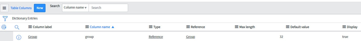

Still seeing blank groups.
I double checked that table and i do have a display value set
