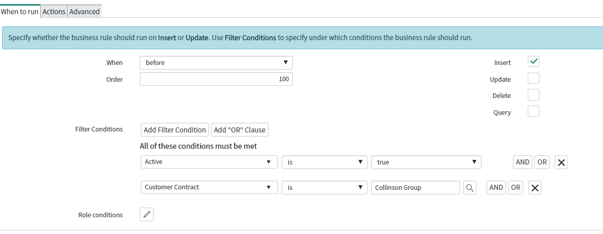

‎08-07-2019 03:13 AM
‎08-07-2019 03:59 AM
Hi Robert,
why to have this as before insert and not async
async business rules are recommended whenever you want to trigger some API call to 3rd party from BR
Mark Correct if this solves your issue and also mark Helpful if you find my response worthy based on the impact.
‎08-08-2019 02:18 AM
Hi Ankur,
I tried async but that didn't seem to make any difference i still got the same error message.
Rob
