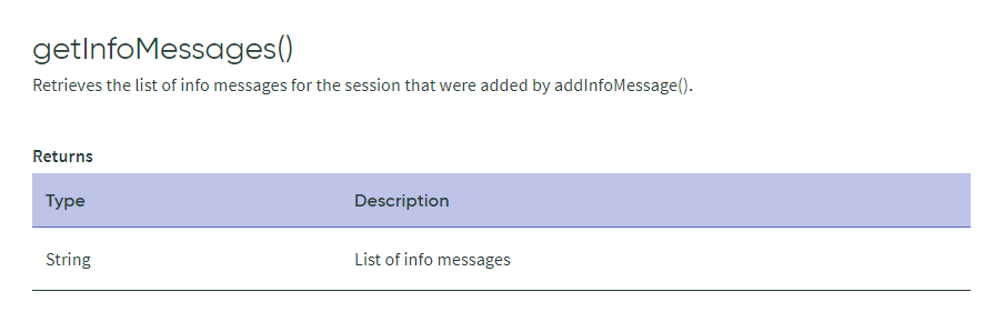

2) gs.getInfoMessage() is used to Retrieves the list of info messages for the session that were added by addInfoMessage().
