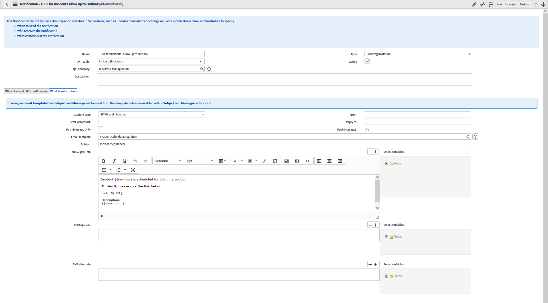

I'm trying to get Incidents to create calendar events similar to when Change Request tickets have the planned start and end time fields filled in.
On our Incident form, I have a field "Scheduled follow up" that when true, makes the "Follow up" and "Actual Follow up Date" fields visible. Both are Date/Time fields so I should be good on the set up so far.
What I've done so far is copy the Notification and Email Template that is used when the Change Request is generated and copied it over to a new Notification template (changed all the appropriate fields to Incident from Change) as well as the Email Template (also changed all Change to Incident) yet I get errors on Outlook when doing this. It creates a tentative event, but I can't actually open the email that would have the event to actually accept it. I get this error when trying:
Is this because the notification was generated on our Dev instance and this is a failsafe against using the Dev instance for production purposes, or am I not putting something in correctly? Other test notifications work just fine, including the Change notifications that generate the calendar event, which is why I'm stumped.
What I have for the Notification and the Email Template are attached as files below.
Thank you for your help!
