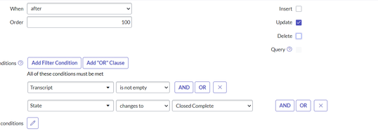

Can you please make sure you have added the proper conditions in the BR?
In my BR, below are the conditions being added.
Nayan
