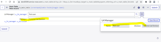

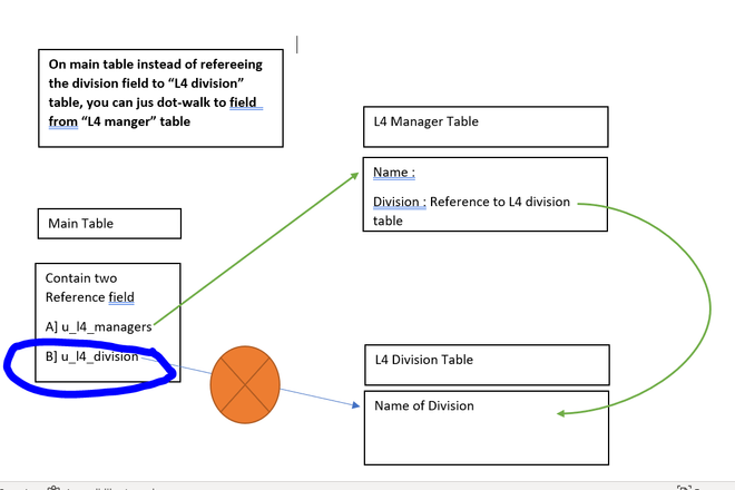

You can configure the form, and get Division field from u_l4_managers table by dot-walking, so when manager gets changes automatically the division will be populated with there manager's division.

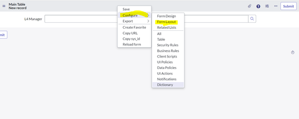

Hi @Andrew Meza

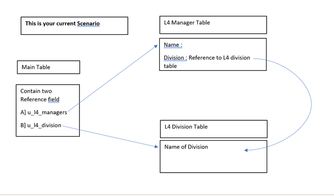

This is your current scenario...(Please let me know if I'm wrong)
You need to implement it like below :
You can use below steps to get division field through dot walk:

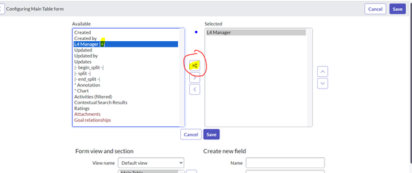

Step 1: Right click on Main form header & click on configure>> form layout
Step 2 : Click on "L4 manager" (+) icon & then expand it (Highlighted in red circle)

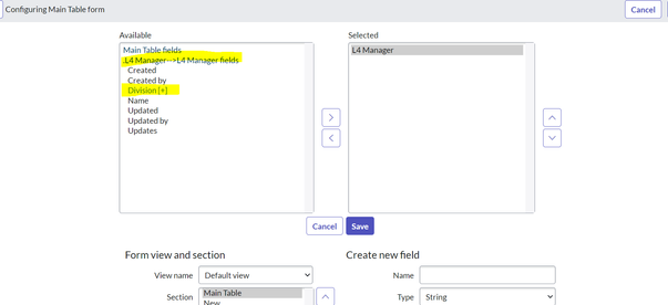

Step 3: You will get the fields from "L4 manager" table , Click on Division field and get it to right side of slush bucket

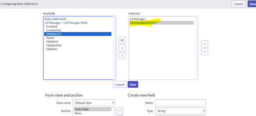

And Save it.
That's it...You will get the division field from Manager table on Main table
So now when you , update the manager automatically his/her division will be autopopulate.
So whenever managers division changes, you just need to update the Division of manager in L4 manager table.
Note : Table names & fields name will be different than yours.
Hope this helps...!!!
