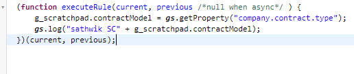

04-26-2021 08:10 AM
Not working
tested....used alert for stracthpad...output like this.."undefined"
04-26-2021 08:25 AM
tested with logs for BR...it was fine...
But those are not getting into client script..
04-26-2021 08:26 AM
Can you share in detail what you tried? Screenshots or something.
